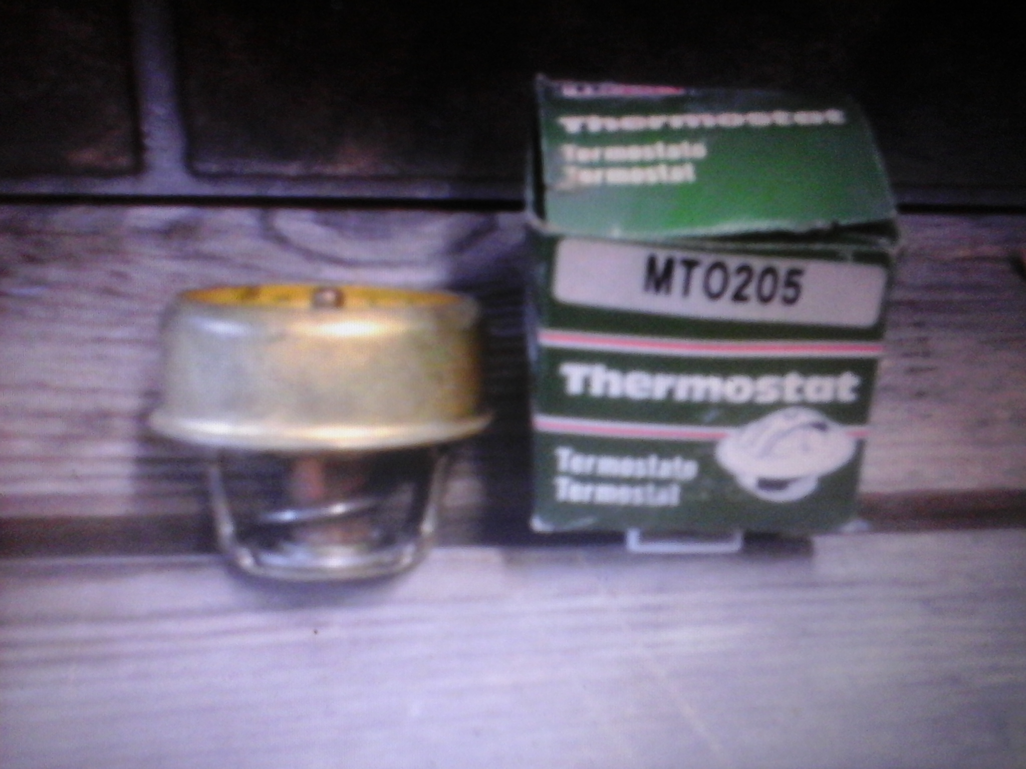

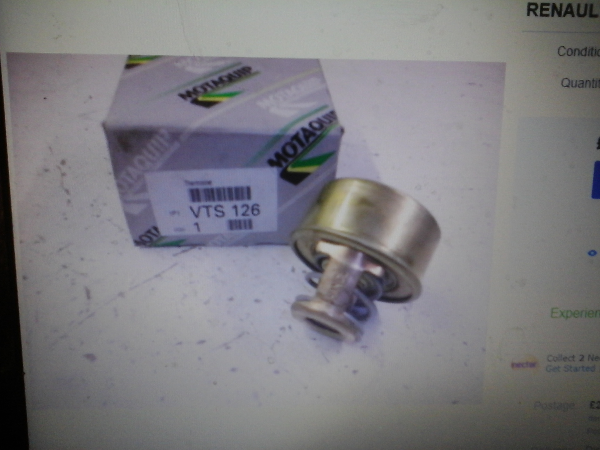

Just checking back my records is this it. One's for a 5 others for a 9..
Attached Thumbnails Fitting a second thermostat...-renault-5-stat.png   Fitting a second thermostat...-renault-9-stat.png

I'm little bit confused about the correct place for the small hole on Renault 5 thermostat.
