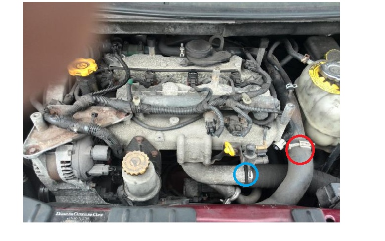

Got new thermostat over the weekend. On picture which pipe do i fit into?
sorry for my ignorance

I fitted In to the top pipe on the right side (close to the coolant tank).

Where exactly. The blue or red circle

I fitted in to the pipe/tube marked with Red circle

3 or 4 pages back there was this picture where you could see the stat mounted
