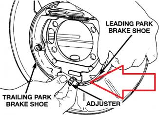

I need to pass the MOT test in Holland (we call it APK) and all seems fine but the handbrake isn't strong enough to pass the test, which seems to be a feature in stead of a bug..
I see all nifty ideas here to get it better but I also found this in my documentation (see picture) isn't that little wheel at the bottom in the drum for adjusting the handbrake?

Vmaxxer -- yes, this is the "classic" drum-brake adjuster as on many cars that used to use drum brakes, you push a screwdriver through that slot you can see in the back-plate and fiddle it up or down to adjust. There are two things here tickling my grey cells...
1) When we did it, there was no adjuster, so mine could have just relied on the auto-just handbrake lever.
2) I'm almost sure the shoes have to be fitted a particular way round here, leading shoe/trailing shoe. We didn't disturb the shoes as they wouldn't wear in normal operation, and they looked ok anyhow. Probably the original ones.

Today I looked at the situation.
My voyager does have the adjuster (wormwheel) and I managed to adjust both wheels to "near brake" with the lever on 2nd click.
Brake appears a little better, but still not happy about the breaking power I removed the wheel, callipers and rotor to look inside.
The rotor/drum looks ok but the shoes are as good as gone, looking at bare metal with slight hints of brakeshoes.
My conclusions:
Someone has driven many miles on handbrake and the rotor/drum has been replaced after that incident without replacing the shoes.
So now daddy needs a new pair of shoes

Leedsman is sopt on, garage failed my 2.8crd and changed discs pads and inner shoes and just passed it this was last year,this year same thing they wanted to replace the all lot.
Possibly conveniently forgot they done it,so after checking the shoe pads springs and levers and applying copper grease where needed I found that just by adjusting the distance from the end-stop and the square spring made the handbrake pull the cable much sooner. 4 to 5 clicks now and the and brake is engaged and very hard to get GV to move forward or backward compared to 9-10 clicks before the adjustment
