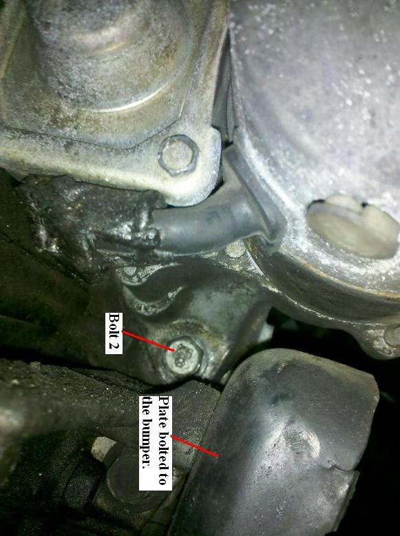

So I found the starter. It's the silver cylinder object in the third picture. But I can't figure out how to take it off. The bolts are all the way in the back! The Hayes manual made it seem so easy, lol. Also, I can only see one cable. I took more pictures:
Do I need to take that plate off? It's got 3 bolts attached to it, a connector in the middle, and then 3 bolts on the other side bolted to the bumper. And where is the other wire?
Second Pic:
Another picture of the bolt, which is further than it looks. It's all the way in the back.
It started raining again, I'm going to go back pretty soon, and try taking that starter off...
