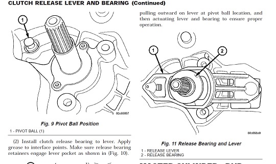

ok, when you press the clutch pedal it should cause the piston in the end of the slave cylinder to move out. When that piston moves out it should press against the release lever, the release lever is "hinged" at the other side of the gearbox, so as the release lever is moved towards the engine it presses the release bearing against the clutch assembly - this is what disengages the clutch allowing you to change gear.
If we are sure the piston is now moving, the next thing to check is that if it is moving the release lever and that the release lever hasn't fallen off of it's "hinge" the pivot ball.
these pictures show it better than I can describe.
Don't give up yet!
