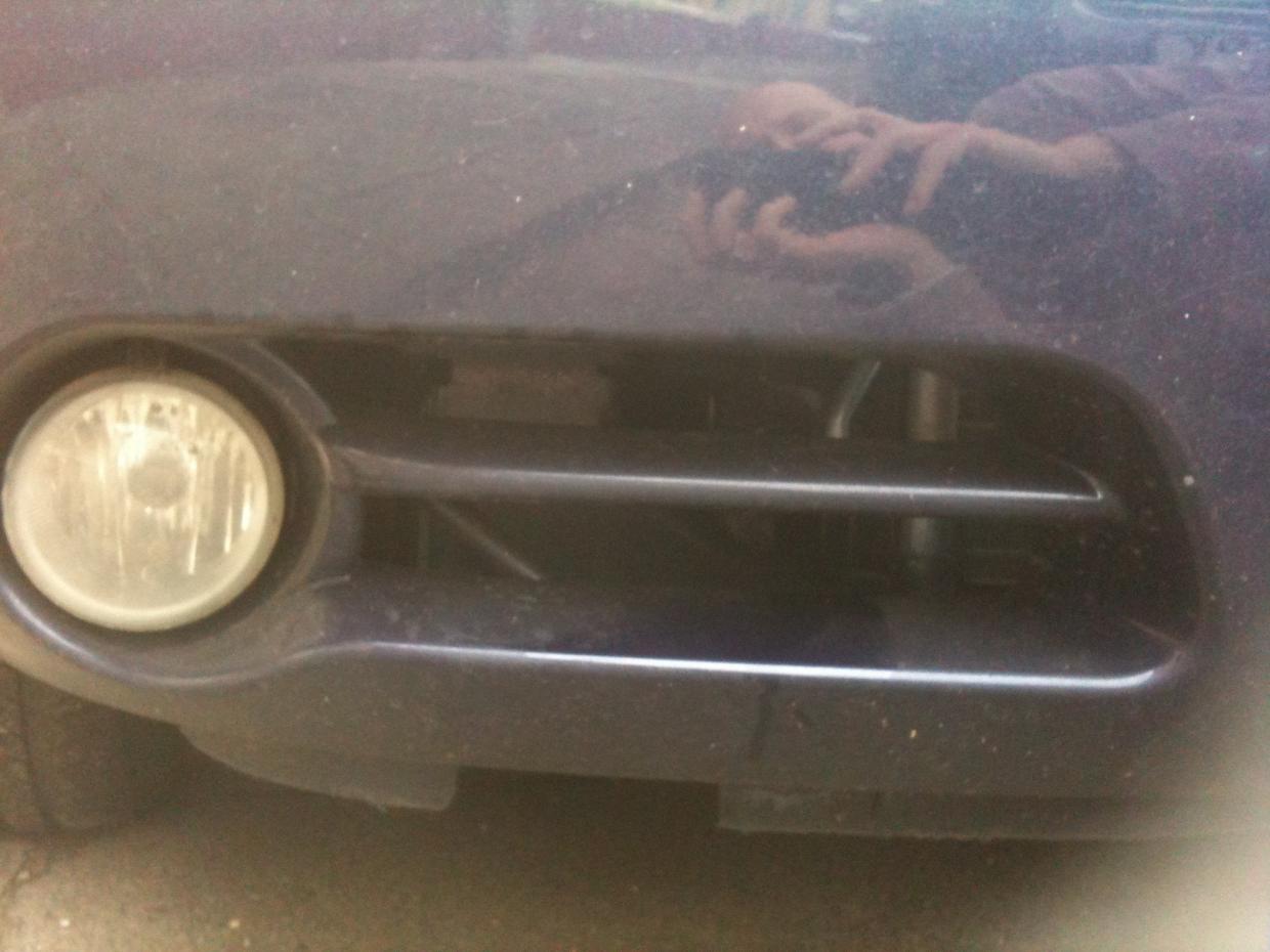

I was planning on changing the coolant a few weeks back on my 56 (84k)plate GV 2.8L oil burner but never got round to it! Its on the cards for tomorrow! My laptop has died so can't access my workshop cd-rom to check the pics. Can anyone confirm that this pic I took is the drain plug for the coolant rad please?🙏😃👍

I hope this has worked! It's on the drivers right side 👍

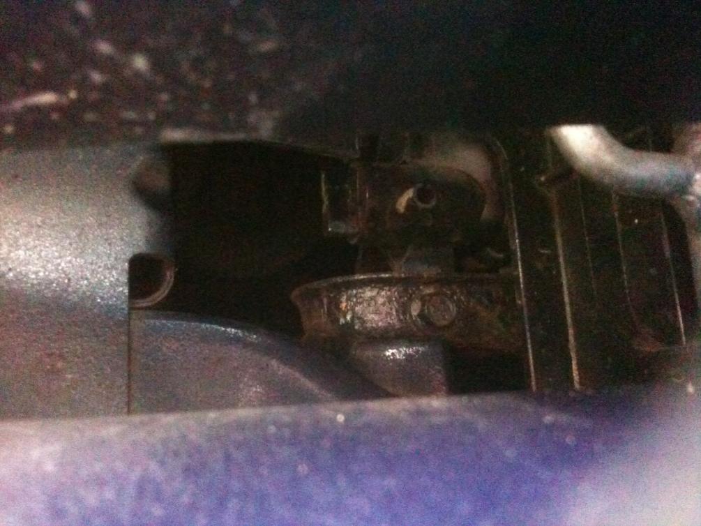

Hope this gives another viewing angle...

My 2002 GV 2,5 crd has the draining plug (plastic lock, you just unscrew it halftwist) was on the left side when you stand in front of car. Radiators left down corner. Barely my fingers fitted from under (you have to take off the plastic covering under engine).

Happy days mate. Thought it looked like the rad drain. I should be able to get my skinny hand through the front vent to be able to turn it.
