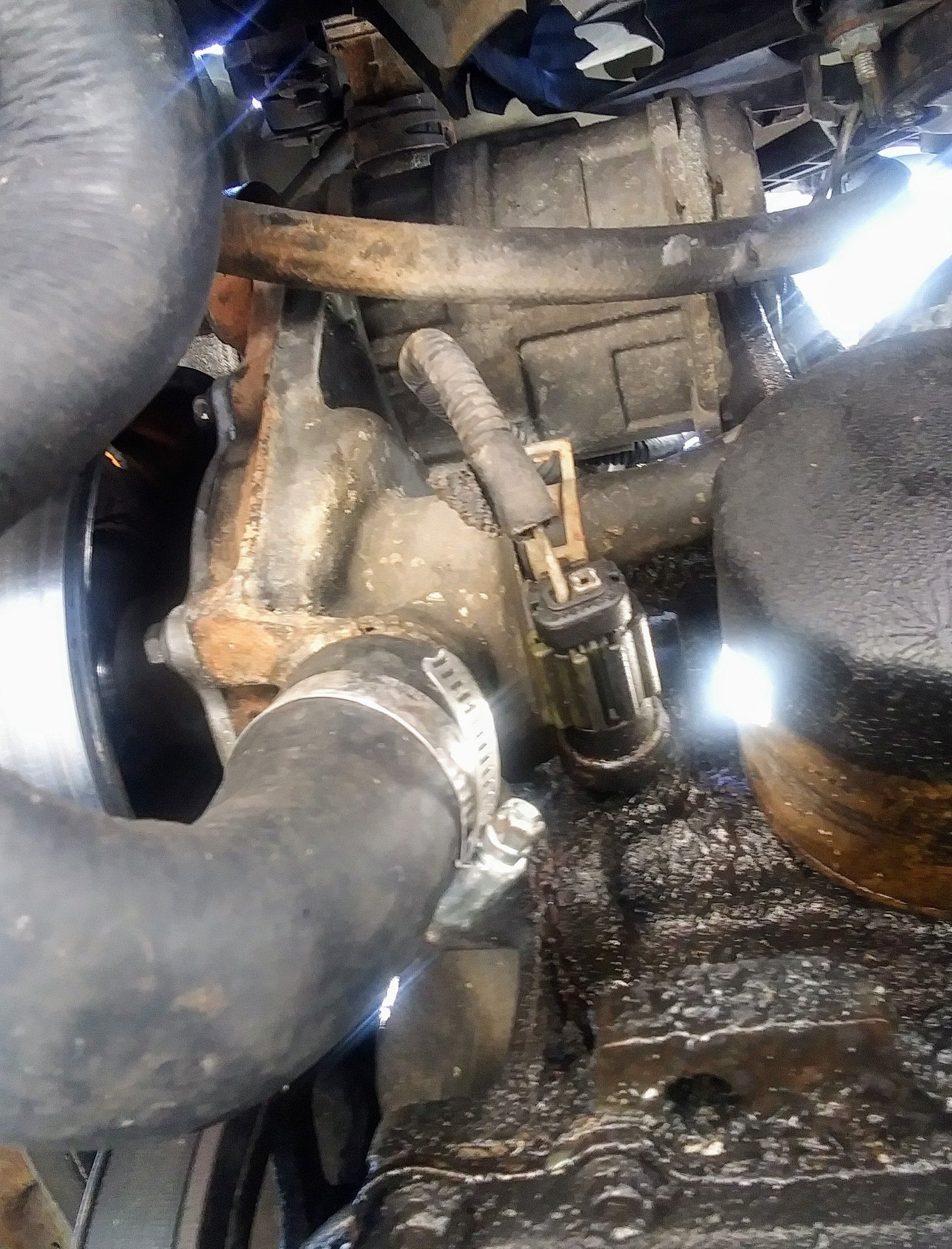

3.3L Chrysler 2000, looking upward and toward the rear.
The big hose is the bottom radiator hose. The oil filter is on the right. Between those is an electrical connector with, apparently, one wire missing. What is it?
Searching on the subject, perhaps the output speed sensor is relevant.
I'm still looking. I still would like to know what the electrical device is that is in the picture.

That appears to be the oil pressure sensor and it only needs a single wire it grounds through the block; over 4 psi circuit open no oil light - under 4 psi circuit closed/complete and the oil lamp lights.
Almost sounds as if the connector to the trans solenoid pack is disconnected (just below the input speed sensor).

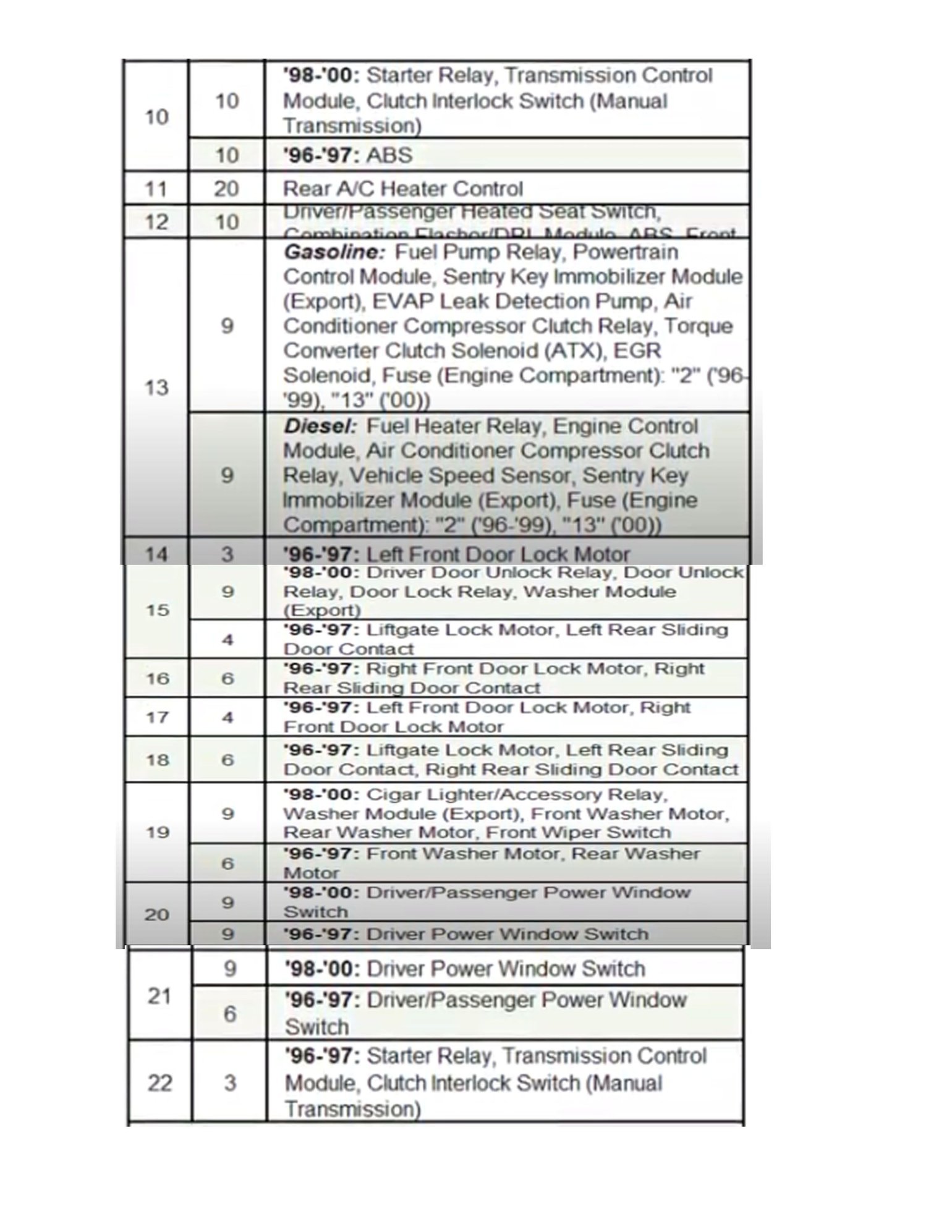

The car starts and runs. However, the instrument cluster is dead. I previously checked the fuses, but I'm going to do it again. Where is a diagram?
Old Apr 16, 2021 | 03:34 PM
Nehmo Sergheyev's Avatar
Joined: Nov 2018
Posts: 19
It turns out the fuse second from the left in the under-dash box was blown. I replaced it, and now the instrument cluster
