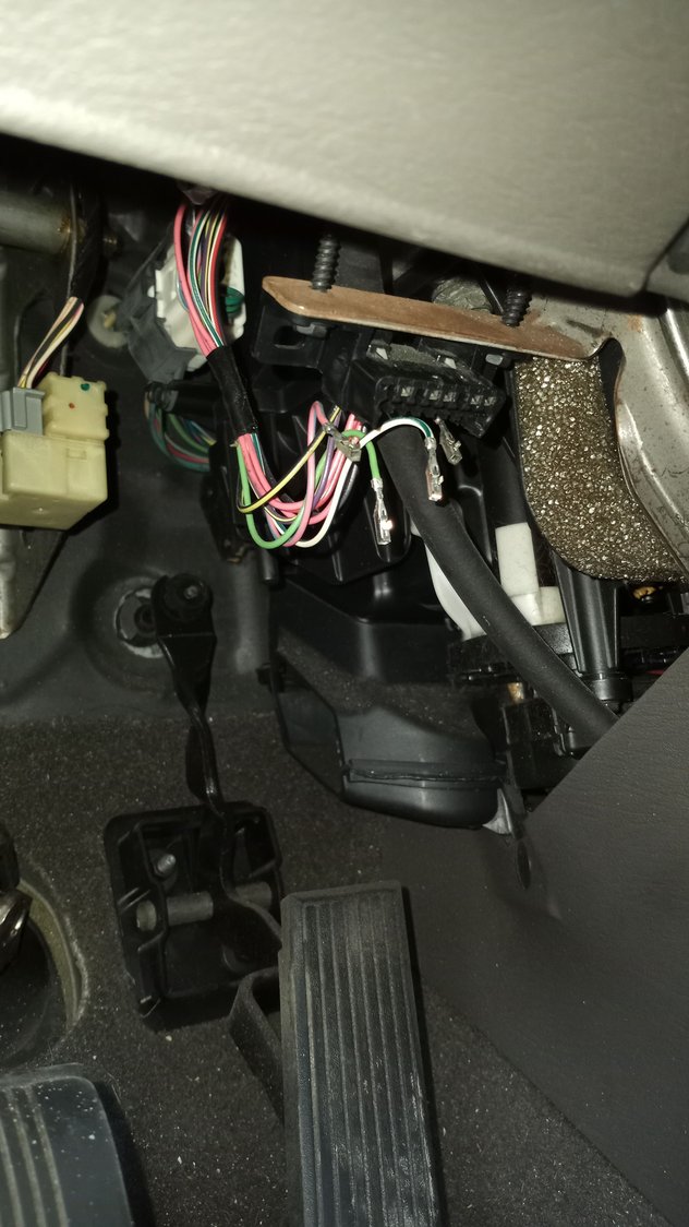

Then noticed the mechanic broke 1/2 the case around the code reader
