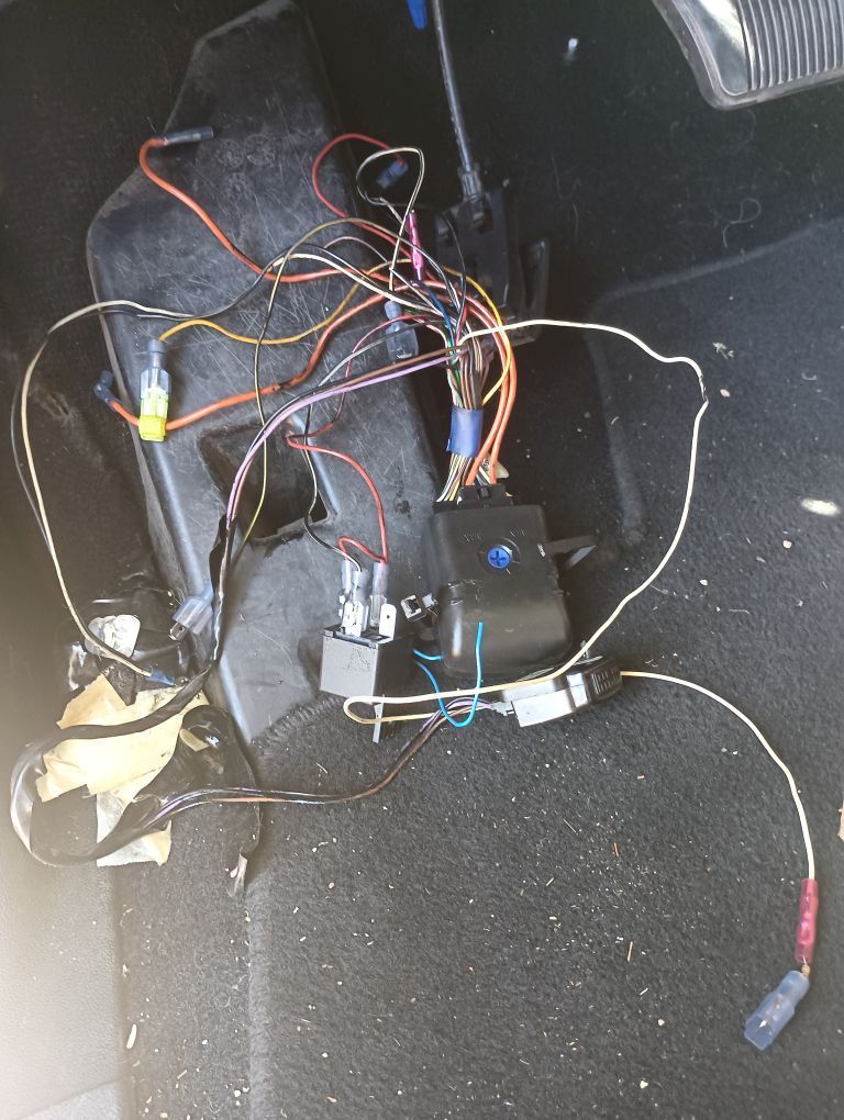

Soooo...turns out my ENTIRE mess was caused by remnants of KARR Security/Disable System tucked way up in dash (seemingly common by Dealers on Lease and Credit Risk vehicles, that previous owner knew nothing about). It was only discovered upon tearing apart entire dash to get at WIN (annoying design). Wad of melted & cut wires and gooey elec tape...relay cut into start-signal wire among tentacles of other wires, connectors & splices...had to do picture search to learn what it might be. It likely explains the weirdness of continuity & no short to gnd from connector-connector at KeyOff & 'floating' (no signal or short) when KeyOn..not really covered in diagnostics. I've never experienced a relay failing that way...somehow changing from NO to NC w/out rewiring ...perhaps an issue with melted wire mess...which, as mentioned in first post, coincidentally happened after driving & parking in 118F Phoenix temp previous day. It was a sticky nightmare removing it all from the vehicle..soldering some harness wires back together..got expected signals from diagnostics...Van started right up & runs fine. 7 frustrating days in the Phx summer heat at a friend's driveway solving this Dealer created mess. ARG!
BIG thanks for assistance here. THIS was a head-scratcher. But glad I now know to lookout for KARR in the future.
Now, if I JUST could figure out where these 3 leftover screws go. ;-)
KARR Melted wire mess
KARR remnants removed
