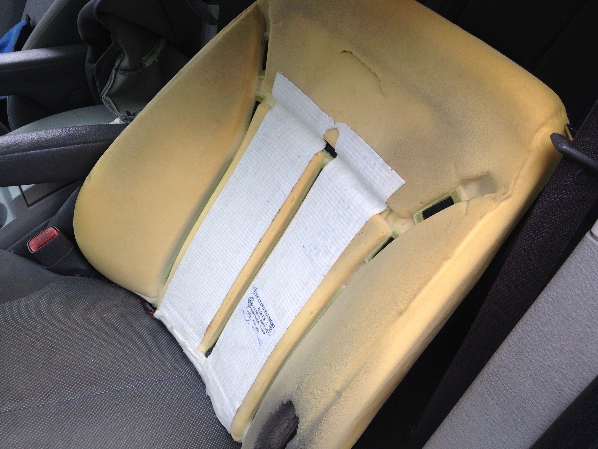

I also dug in to the front passenger seat, and when I removed the cushion foam there was a tag saying not to separate the foam from the Occupancy Classification Sensor.
Although, even though the foam isn't actually physically bonded to the sensor by any means, apparently it's too late by the time you find the warning.
So I will make sure to leave the foam in place in Blue!

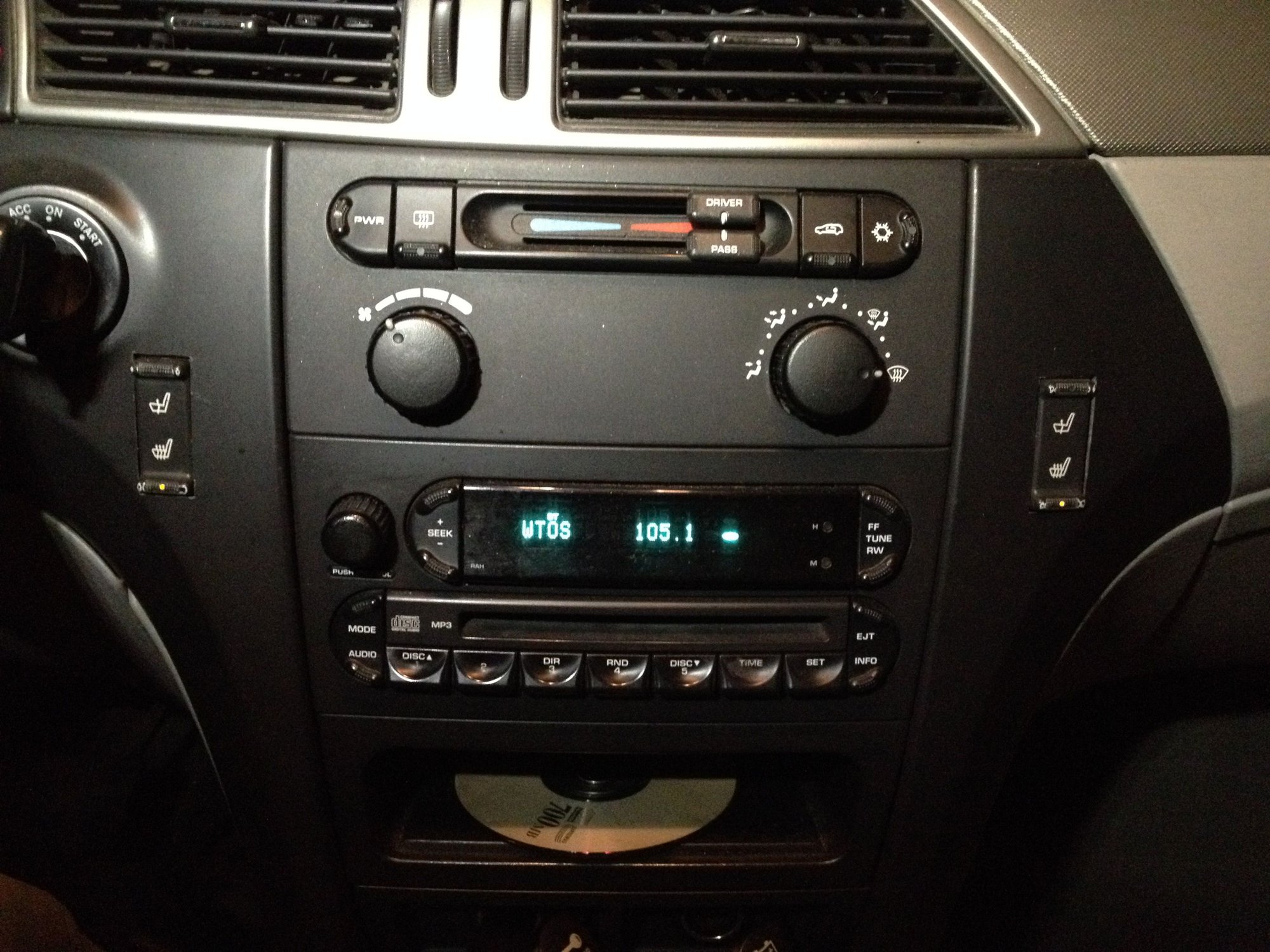

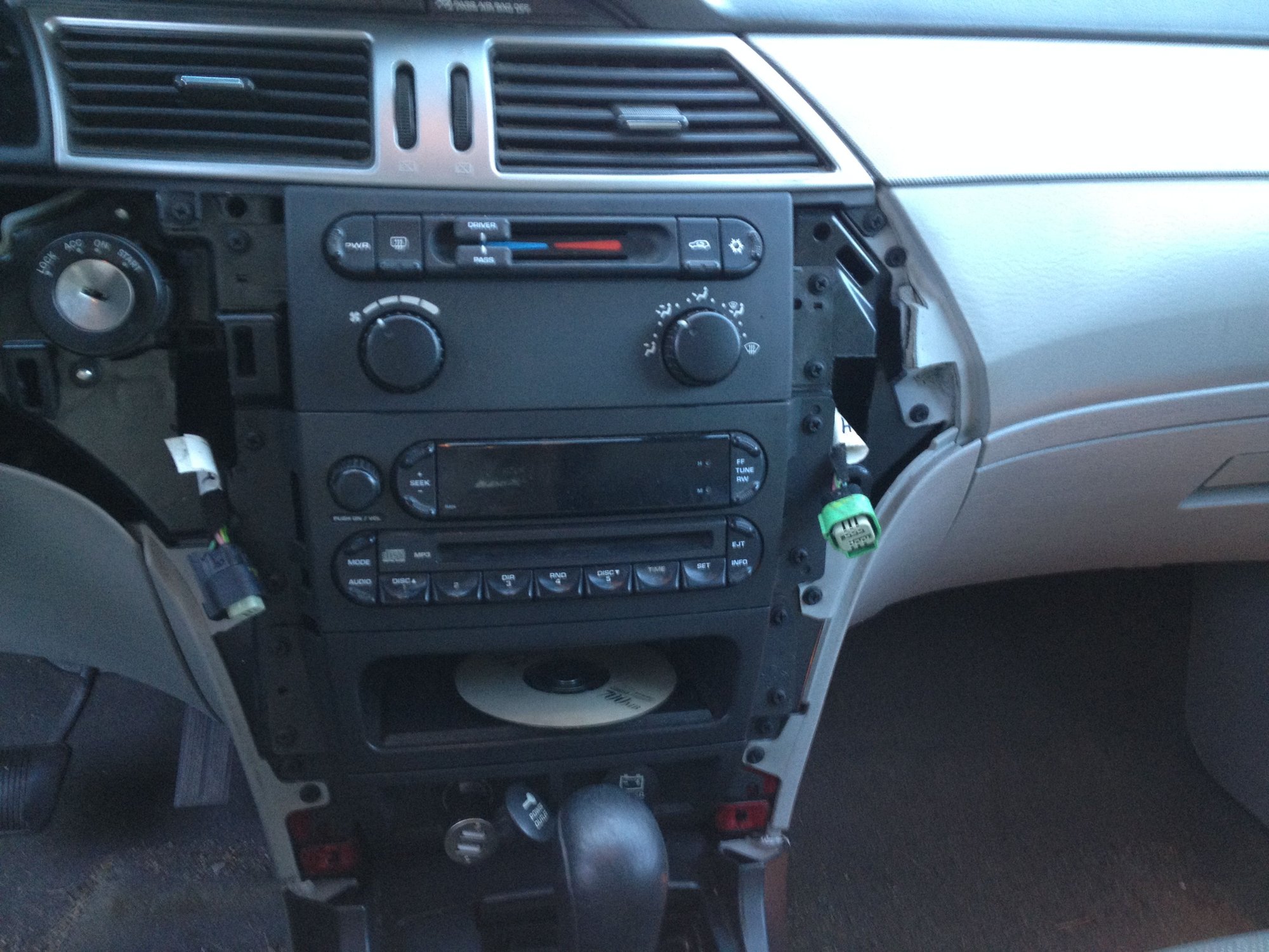

So, today I spent a huge amount of time finding a space for the two switches.
Not only did I have to find a spot big enough for the switches, but also deep enough to accommodate the connector and wiring for each, as well as a place that has the same curvature as the switches.
After careful measuring I finally found a spot on each side that came as close to perfect as I could hope for.
Then with extreme patience and steady hands, I took the Fein tool out of the work van and cut the holes for the switches.
I kept test fitting the switches and filing the openings to keep the absolute minimum of clearance between them.
Once I was satisfied with the fit and finish of the switches I glued them in place from the back side with Shoe Goo.
That stuff has a tenacious grip and remains slightly flexible after it cures.
Then I spent a couple of hours of trimming, test fitting, and repeating until the two trim pieces snapped perfectly back in place.
I hid the rear heated seat module in the void behind the radio and the cubby below it.
I need to get the power wire into the fuse box and put the heating elements in the seats to finish.
Hopefully I can finish it in the evenings after work this week!
The driver side is all set for the trim piece to go back on. The passenger side still has much trimming left.
The switches almost look like they belong there!

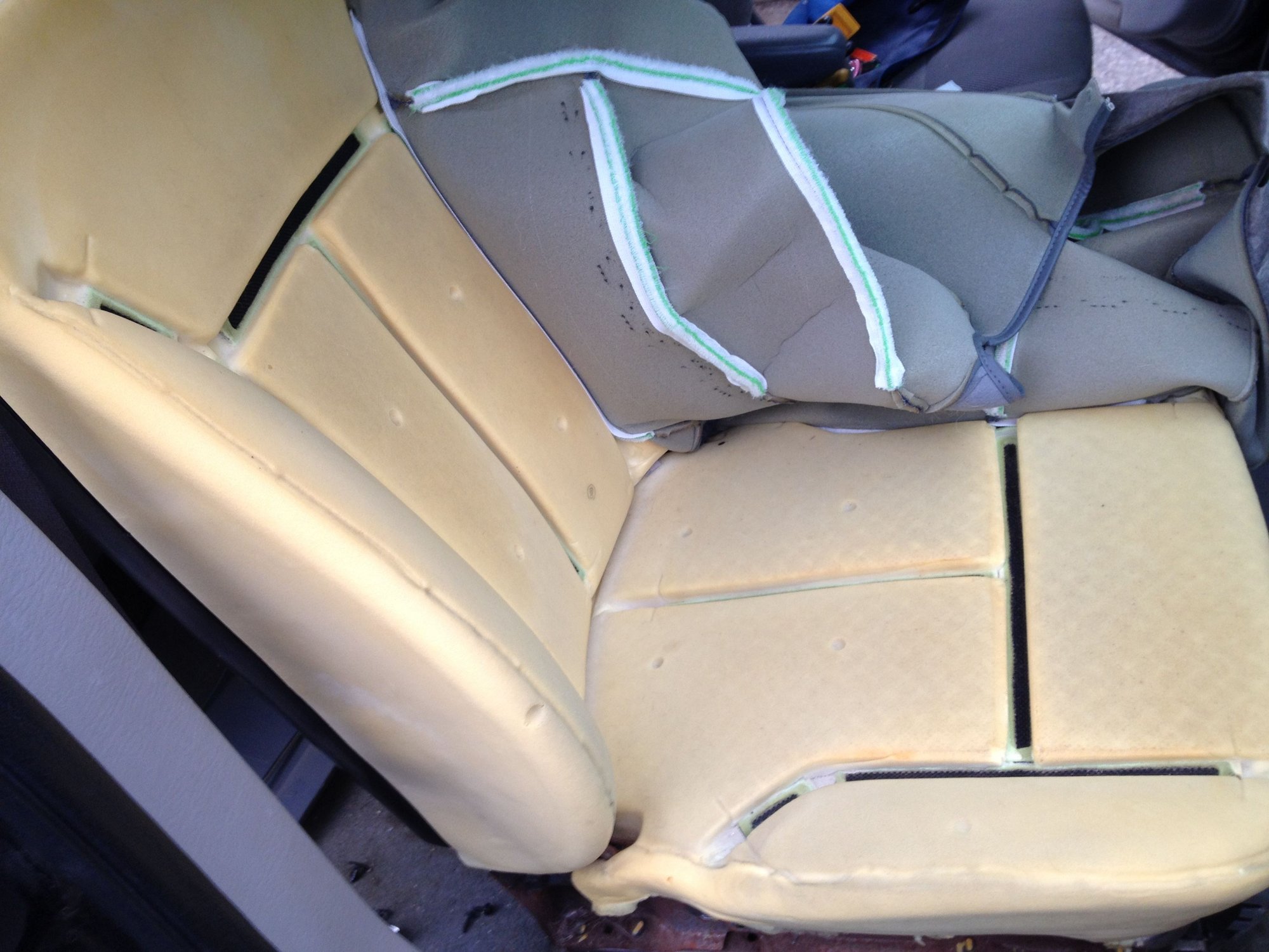

So, today I installed the heating elements in Blue's seats, ran the wire into the PDC, and put the fuse in slot #44 and was totally successful!!!
I took the upholstery off the seats just far enough to put the elements in place and used some Super 77 spray adhesive to keep them where they belong!
It is so awesome, I spent quite a long time "testing" them!!! Lol
The top is LO, and the bottom is HI. Both LEDs are on solid and the heaters are working 100%!!!
About 2.5 hours was all it took to finish, including the half hour it took me to figure out that I had put the connection in the wrong space in the connector on the first attempt. Lol
