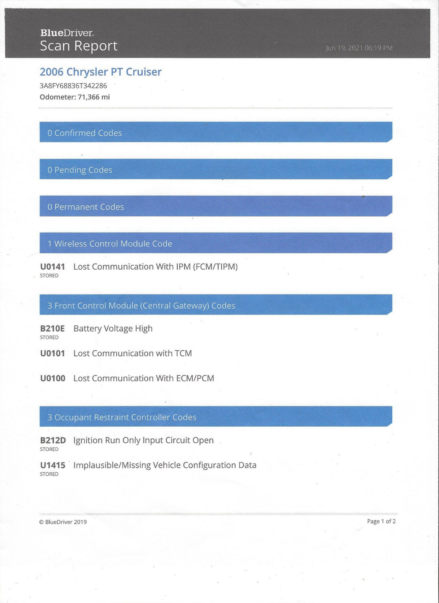

I see that when I unplug the PCM for a bit then plug it back in, the car starts and runs great. Now, that could be a PCM issue or it could be me moving the harness around.
I have seen many posts on this same issue but I have never seen a solution.
Below is a copy of the scan report;

Am I correct in assuming that, by "unplugging" the PCM you mean pulling all 4 connectors off the actual PCM?
If so, yea you might have either disturbed something back into place, or you effectively "rebooted" it. I was going to suggest, pulling power from the battery and letting everything reset, before moving on.
I'd clear all the codes now and see what happens, as you no longer have a baseline to work from.
