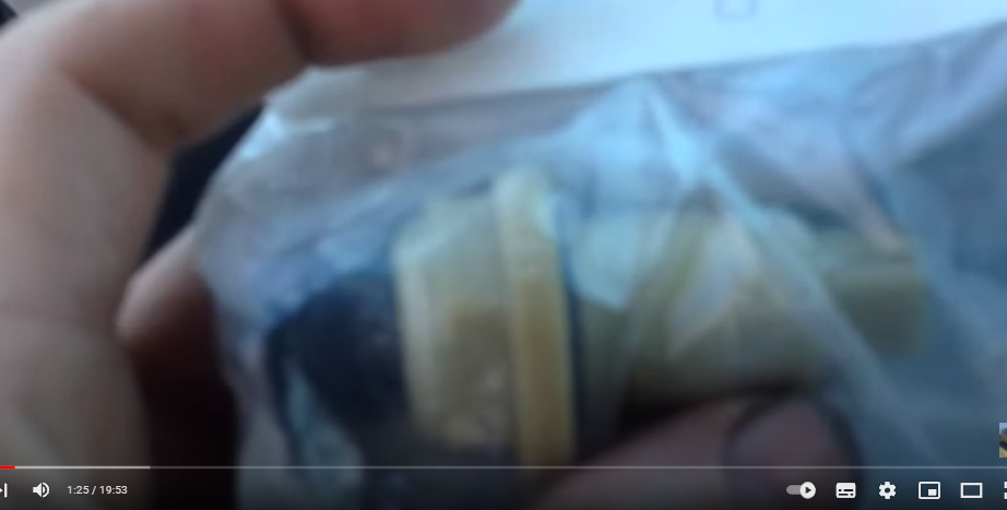

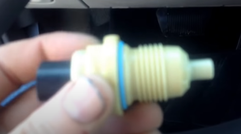

in a video he says that this outputsensor is NOT identical to the intput by having this end to it. ??
input
