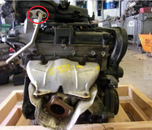

I found this image on EBAY of what the back of my engine looks like. I found a massive leak in what is perhaps a seal or gasket that is possibly mounted in this fitting juncture. (See image)
While the engine is running, you can hear the massive leak and place your fingers back behind the engine at this connection and feel the leak. Could this be causing my erratic idle control?

Yes, there is a blue seal/gasket behind the plate called the egr tube seal. The bolt sizes are 8mm and 13mm. The difficult part is pulling the tube far enough out to replace the seal, at least 1/2 inch.
Yes, if it a massive air leak as you describe it will cause an erratic idle. You may have located the problem. As a note it is necessary to remove the plate when replacing the spark plugs as the intake plenum needs to be moved out of the way to get to the plugs.

Installing the new seal at this fitting fixed the idle problem as you suspected. Thanks for your insight!!
