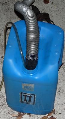

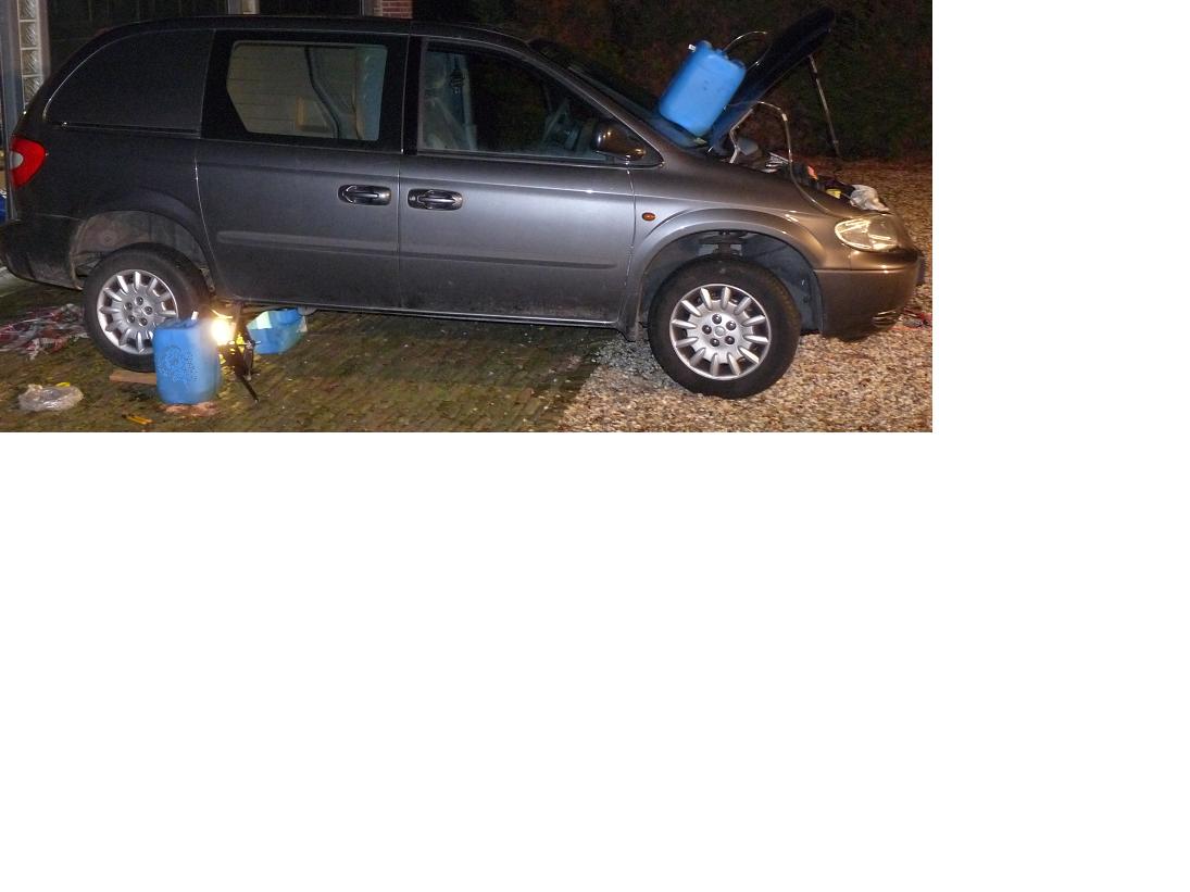

At the front of the car, connected a plastic tube to fuel line (see picture) that runs to the HP pump. Had to remove the triangle shape frame that sits on the alternator for that. Closed off the line to the HP pump. Operated the lift pump without cranking. First diesel blows into the tube, but soon this changes into a mixture of (mainly) air and diesel. It is not possible to pump large quantities of diesel. Definitely not good!
Next went back to the lift pump. This is connected with 2 fuel lines that go to the engine and 2 lines that go to the tank. Disconnected the suction line to the fuel tank (this has a slightly larger diameter than the retour line). Connected the pump with a second plastic tube that leads to a jerry can of diesel. I can now use my car to pump diesel from 1 jerrycan to another (see picture).
Then applied the lift pump again. The result was that at the front fuel without air bubbles was pumped out. Conclusion: it seems there is something funny with the fuel tank.
Next step I tried to blow air through the suction pipe, but this appeared to be blocked. Then used a bicycle pump to apply more pressure and the line suddenly gave way with a plopping sound. Hope I did not damage anything doing that. After that I could blow air into the line end could hear the end of the line was below the fuel level. [Edit 2010 02 15 by Jacob: Not a good idea to blow air in the suction pipe of the tank. This way you will damage a leak back valve inside the fuel pickup unit.]

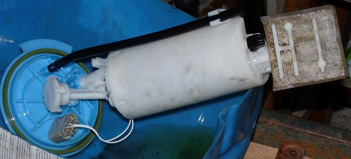

Then went on and removed the tank from the car. After I had opened it I could see a that the suction unit has a filter attached to it and this filter was totally covered with a grease like dirt . The picture was taken after I had taken the dirt of. Cleaned everything as good as I could and put everything together again.
Repeated the experiment with the lift pump again, expecting that there would be no air at all. This was not exactly the case. If one continues to use the lift pump, it will still blow some air. However the amount of diesel that was pumped was considerably more than before, I could pump 5 liters in short while. So at the end assumed that this was normal and put the car together.
The dirt that was found in the tank had a green-grey color and I assume that is due to algae growth that one reads about on the internet. I am pretty sure that this is what has been causing the problems. To prevent new contamination a product against micro organisms was added to the fuel. Also it has been very cold lately, so I don't think these are good growing conditions anyway.

- Connect a plastic tube to the fuel line at the front (see previous post);
- Operate the lift pump a few times (do not start). Check if there are many air bubbles visible in the plastic tube;
- Another check you can do is to connect the tube an external pump. In my case I did not have a pump and a used an industrial vacuum cleaner combined with a jerrycan (see picture);

You may check the fuel tank in the following way:
- remove most of the fuel from the tank but leave some fuel in. I found using the tube at the front combined with an improvised pump a handy way to do this;
- disconnect the fuel lines from the lift pump;
- remove the bolt on the front of the tank and loosen up two bolts of the tank in the middle of the car;
- disconnect the electrical connection to the tank (slide open the red strip on the connector first);
- remove the two bolts that hold the tank in the middle of the car and lower/tilt the tank to support (no need to disconnect the fuel filler);
- connect a plastic tube directly on the tank;
- connect the tube to a pump and check if air appears in the tube.
In my case air started to appear only when the suction was increased above a certain level. This explains why operating the lift pump brings air in the system, while at normal driving conditions there was continuous fuel supply.
If the air is coming from the tank, you can remove the fuel unit:
- With the tank in tilted position, remove the fuel unit (no need to remove the tank);
- Inspect the fuel inlet sock If it is plugged, fuel can only pass at a slow rate. When more fuel is needed per time unit, the unit will suck air instead;
- Normally there is no need to take apart the fuel unit, but in my case there apparently was, as this is the second time I have removed the fuel unit;

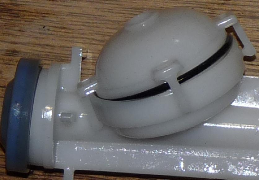

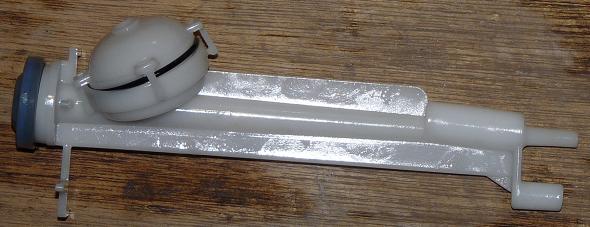

- Inside the fuel unit there is a device with an iron ball in it. Exactly what it does I don't understand, but it probably has to do with fuel supply when taking a corner. It also operates as a one way valve.
- In my case it had sprung open (see picture), probably because I had applied air pressure when blowing the fuel line a few weeks before. As a result, the fuel inlet point is higher then before, which gave trouble when the tank was near empty. Also fuel is allowed to flow back in the tank when the engine is off.
