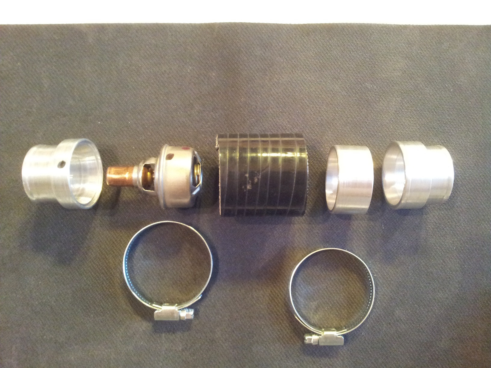

Ok I'm about to collect my new Renault 5 thermostat..
But still not completely sure which side should point to the engine?
And where exactly to drill the 1.5mm hole?

I studied my new thermostat and I think the direction and the hole should be like I put in the following picture:
if not, please enlighten me
Old Dec 4, 2014 | 09:05 AM
Yes you have it right, the wax pellet always goes to the engine. Where your little drilled pressure hole goes is wherever you can drill it safely, I put mine right though the rolled lip - see here.
