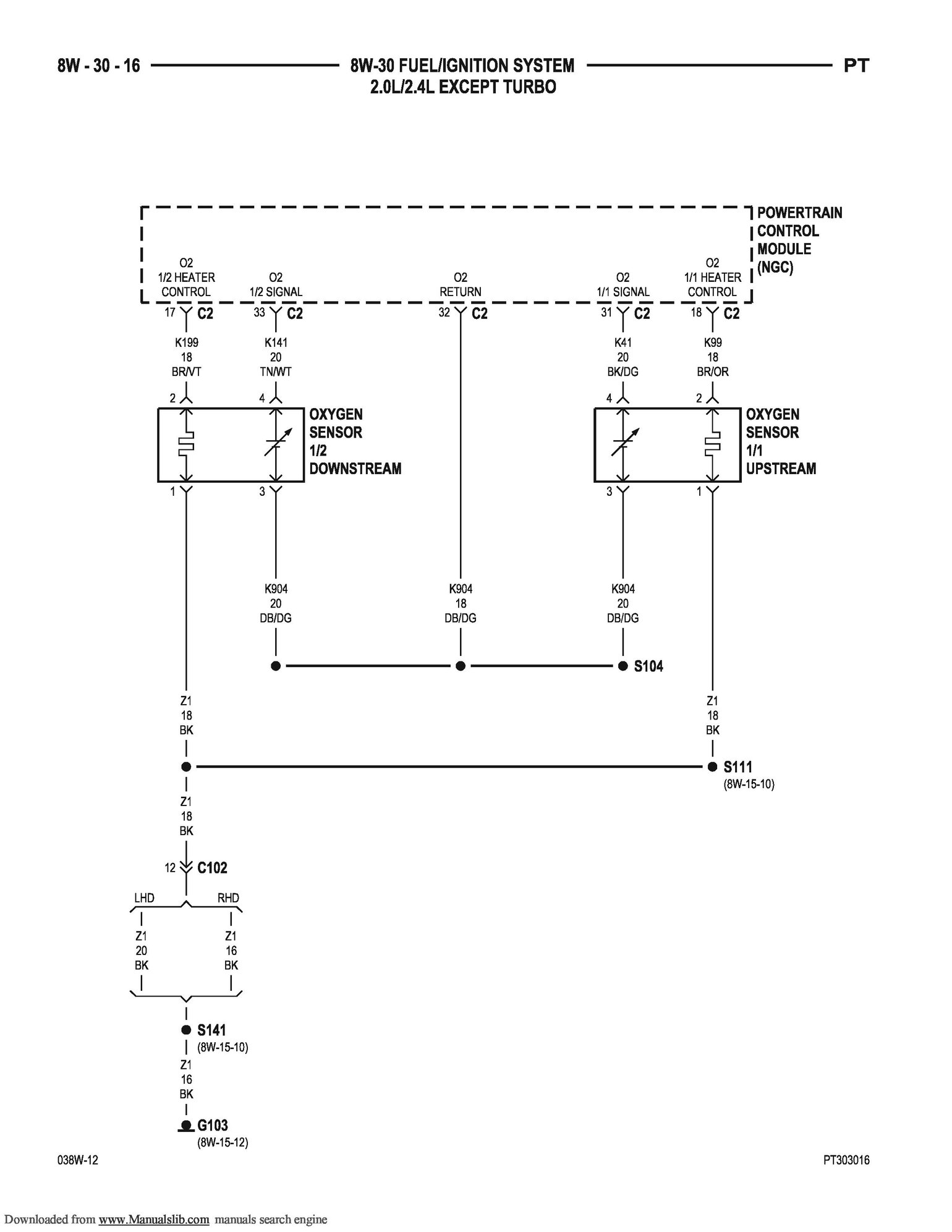

why are you ordering a PCM?
before spending another dime, why not spend some time TESTING the wiring to make sure it's intact?
Old May 12, 2023 | 12:28 PM
TeyM's Avatar
Joined: Apr 2023
Posts: 8
could you tell me where you would start? Thank you
Old May 12, 2023 | 09:45 PM
sota's Avatar
Joined: Apr 2022
Posts: 101
get a copy of the service manual.
start mapping out the wires from the ECU to the O2 sensors.
with both of them showing "high", I'd start tracing from the ground point back to the sensor.
I'd also check C102 and make sure it's connected.
