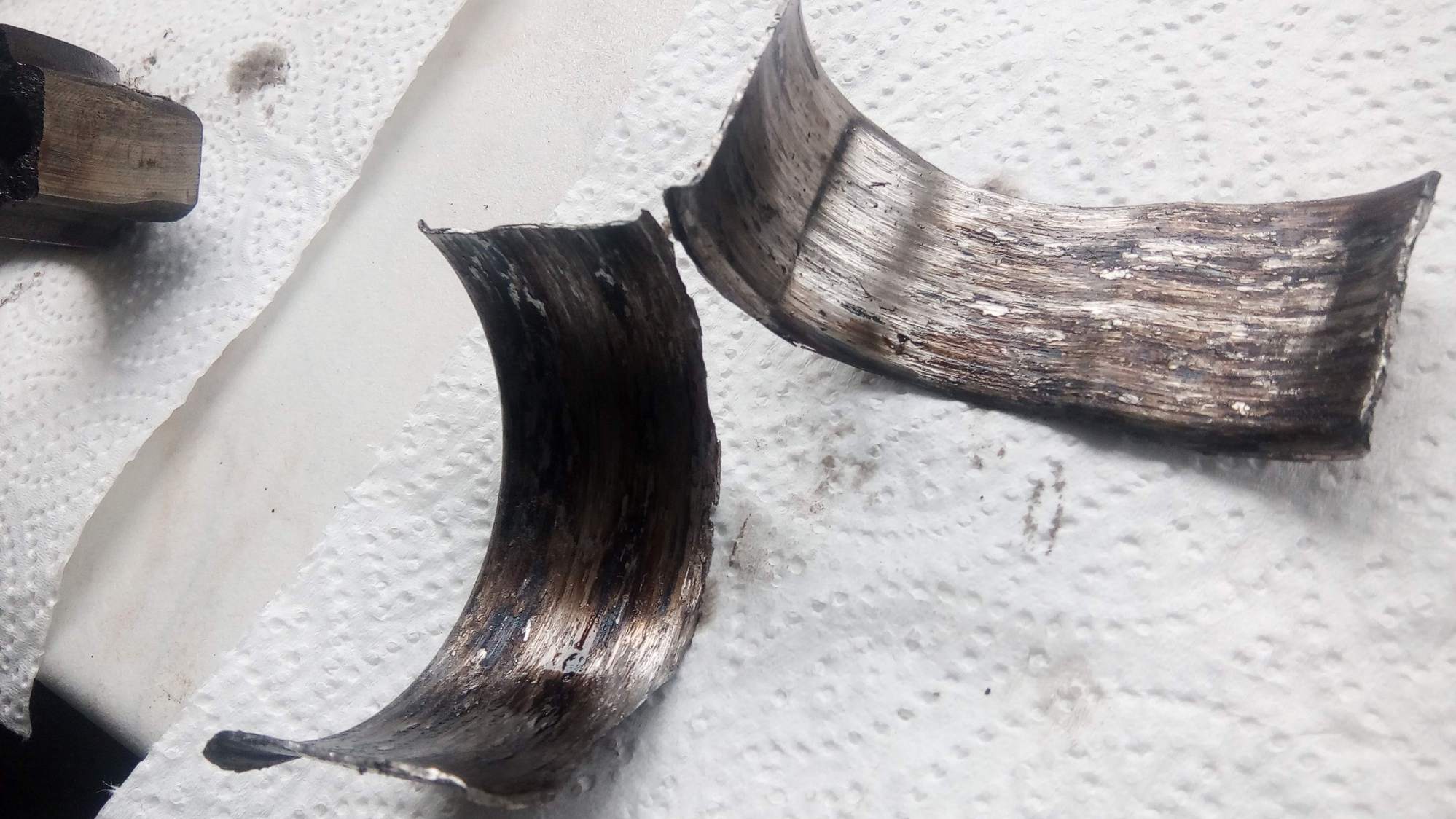

Well, not wanting to leave an open end, the conclusion is that it's getting carried away to the scrappy sometime later this week (Giving me £80 for it, including pickup). Unfortunately when we dropped the sump, balance shaft assembly and oil pickup (Oil pickup O-rings were spot on) we felt rattle on cylinder 2 big end. Took it apart and WOW we found an amazing failure. Dropped the lower piece off, and NOTHING, no bearing at all, it had become sandwiched against the crank. So prising that off and it was in a bad state. What was worse was the upper bearing that had semi-welded itself to the crank. As you can imagine the crankshaft itself didn't look healthy, so being realistic it would be crank out, sand/grind it smooth then replace bearings with additional mm thickness. Way too much for me and my dad to attempt and too costly for a garage really.

Images (hi-res) of the big end failure and crank are below for those curious:
https://imgur.com/a/28YRQLY
