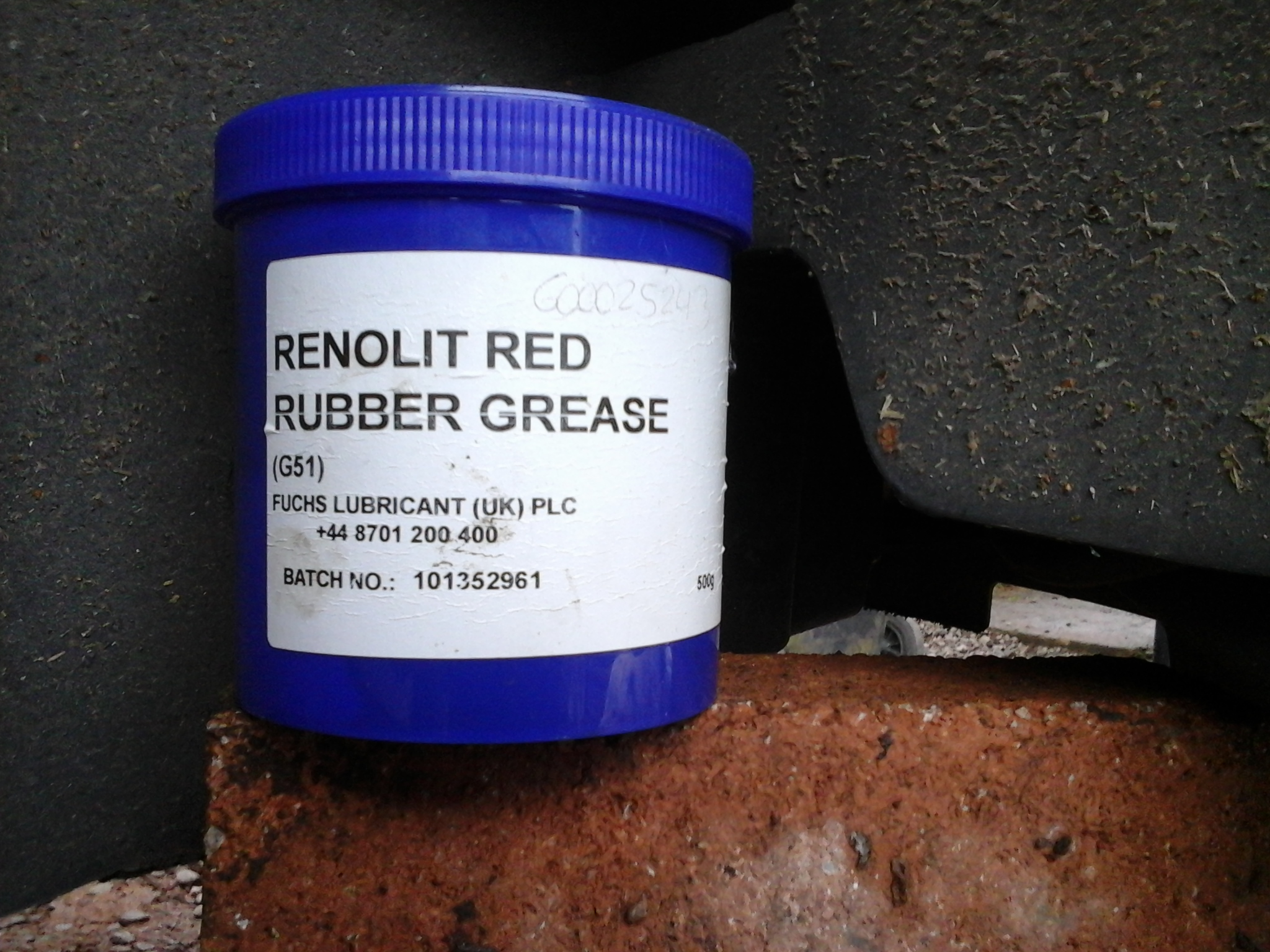

And rebuilt the pistons/seals in the calipers with red brake grease and that will give the pistons better lubrication. New dust covers of course.
Attached Thumbnails FRONT BRAKE PROBLEMS - VOYAGER 2.5 CRD Year 2006-chrysler-abs-red-grease.png
