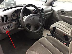

Originally Posted by Quickhick
no interior lights ,no dash lights
My 2007 is a fourth generation model, yours may be different. On the fourth generation models there is a vertical rotary switch on the dash but near to the drivers door. This switches the interior lights ON/OFF/AUTOMATIC.

Dims the odometer and radio is all presently
